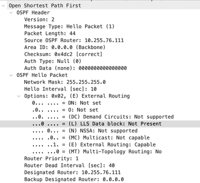

Does Cisco Meraki support Non-Stop Forwarding?
Is enabling Non-Stop forwarding on the routing core (not Meraki, Cat 4500x) with MS 350 peers downstream a bad idea?
KarstenI
I never heard of Meraki supporting NSF. So I took a short capture of an OSPF hello from a Meraki switch:
No option for this extension. I would keep it disabled on the core.

If there are peers using NSF, it should not cause any trouble if it is enabled on the core. The NSF-capable switch will see that the MS is not capable and just ignore this feature. Still, I would disable anything that is not needed.
