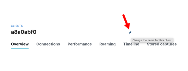

If you were to click on the client with the long string you should be able to change the name by clicking on the pencil and putting whatever name you wish for this device.
Or you can set a DHCP reservation with the client device's MAC address and put a friendly name.
Either way you can adjust the UUID client ID to a more friendly name.  The DHCP reservation would likely offer the best approach if this particular device connects to the network on a routine basis while it might seem like a bit more manual work upfront it will keep your device names cleaner (long term).
