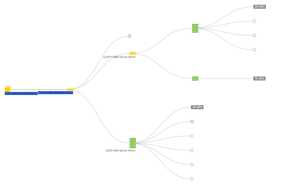

Hi All, Our structure is full Meraki. The core switch has 300 Mbps dashboard throughput but site switches have only 16 mbps. What could be the reason?

Hi Ryan, Thank you for replyingScreenshot 2023-09-12 180153.png. But when we check from MX firewall and core switch throughput values are ok.  we have 2 mx450 active/passive. i swapped but again same issue continue. There is no user now. I m testing it and still bottleneck somewhere.
