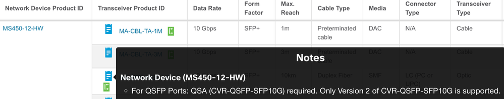

Ryan_Miles
Meraki Employee All-Star
As mentioned by others no breakout cables are supported. The only converter supported is the CVR-QSFP-SFP10G version 2. This is mentioned here https://tmgmatrix.cisco.com/?npid=2301
Anything outside of the above is not tested or supported so you may luck out and it works, but likely it will not.
