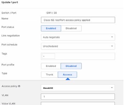

  4. Go to Switching > Monitor > Switch ports
  5. Select the Access Policy created above
    You can as many ports required for Wired posture

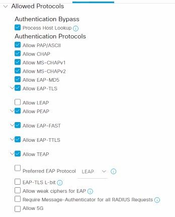

  2. ISE > Work Centres > Posture >Policy Elements>Allowed protocols
    Add new
    Select required EAP protocols only ( I had selected all for time being), rest all were default settings.
    Read the section “Choosing an EAP Method” from here - https://www.intel.com/content/www/us/en/support/articles/000006999/wireless/legacy-intel-wireless-pr....

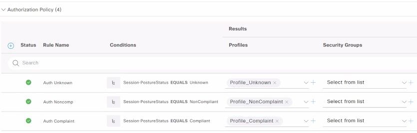

  11. Open authorization policy and create three new policies as below;
  12. Save the policy

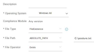

  13. ISE > Work Centres > Posture >Policy Elements>Conditions
    Create your required condition. I have created a simple file condition;

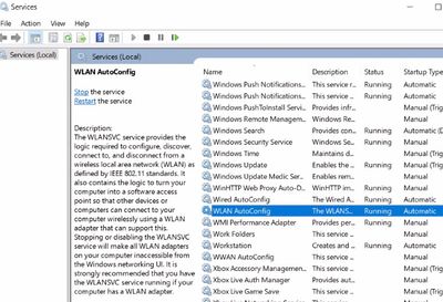

Endpoint Configuration

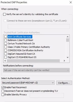

For 802.1x authentication to work client system network adapter should be configured as below. You can choose which EAP authentication to use. For this setup I am using basic EAP authentication without certificates.
EAP-TLS: relies on client-side and server-side certificates to perform mutual authentication. This is considered one of the strongest EAP types however, it requires each and every client to have a certificate pre-installed.
EAP-PEAP: requires only server-side certificates for the client to authenticate the authentication server. PEAP is known as a tunneled EAP type because it first establishes an outer tunnel using TLS and then sends the credentials via an inner tunnel. The inner tunnel can be virtually any EAP type but the widely used inner method is MSCHAPV2.
EAP-FAST: is very similar to PEAP, it first establishes an outer TLS tunnel. Inside this encrypted tunnel, a secondary inner EAP method (such as MSCHAPv2) is used to authenticate the user.

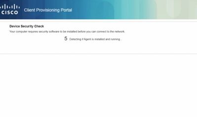

Testing the Setup

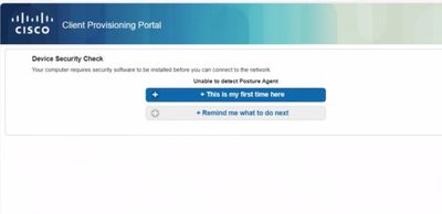

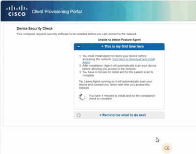

Connect a laptop to the switch port and access any website. You should be redirected to the ISE portal as in below screenshots.

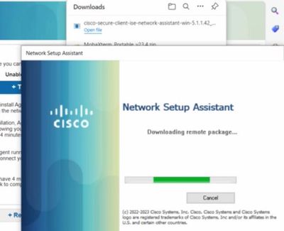

You can download the IE secure client from the redirected portal and install in the laptop.
Once installed, the client checks for posture compliance and permits you to the network.

KarstenI
Then I really would re-think about not requiring the validation of the server certificate. This is the number one attack vector for 802.1X implementations.
