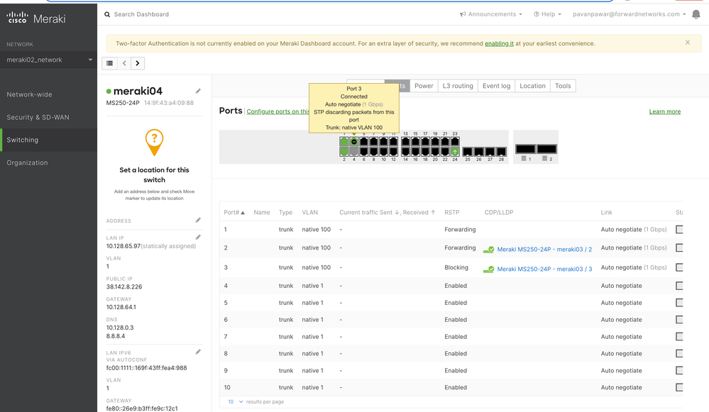

Pavan_Pawar
Hello @RaphaelL
On the UI, Interface 3 shows blocking though the API response shows 'Connected'.

RaphaelL
That's because Meraki thinks that it is a normal condition. You probably don't have BPDU guard on that port , hence you don't have any warnings.
In that case , I don't think you will be able to spot those via the API.
