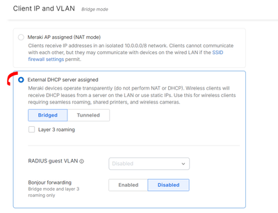

And if you want to get IP from DHCP server you need to configure your SSID to bridge mode.
InfraEngineer20
can we bridge Meraki DHCP to our own on prem 802.1x wired
Bridge Mode
In bridge mode, the Meraki APs act as bridges, allowing wireless clients to obtain their IP addresses from an upstream DHCP server.

Bridge mode works well in most circumstances, particularly for seamless roaming, and is the simplest option to put wireless clients on the LAN. Layer 3/7 firewall rules and traffic shaping can be used to restrict client traffic before it can reach the wired network, and VLAN tagging can be used to put wireless clients on a specific subnet upstream.
