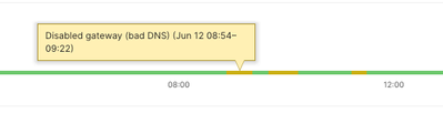

And also we started to get Disabled Gateway (Bad DNS) errors on the MX uplink randomly
