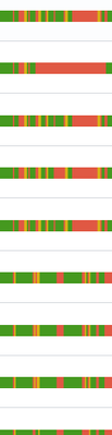

Yeah, only the MS390's the 210's have been fine. The update applies to all now that the 2 switches that wouldn't update have been replaced. But, right after the update applies all the 390's go down and up over and over. Not a sight I want to see any more:
