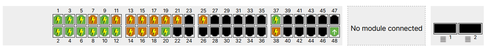

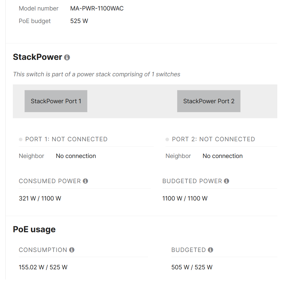

Running CS 15.21.1 on MS390UX-48. These have 1100 watt power supplies but only 525 watts for POE. We didn't recommend this combo to the client. I believe they worked with a Cisco system architect that recommended this setup and brought me in for install.
I've already recommended a 2nd power supply but really hoping there is some upcoming change that addresses this.
Client bought 9166 APs to use on them. They are only drawing 12-13 watts each but calling for a 45 watt reserve. The issue is the switch is denying power based on reserve instead of consumed.
