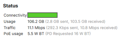

Screenshot from working G4 pro camera.  Havent had a chance to do packet capture on working camera yet.  I will say there is a 50% chance if I unplug and replug in any of these that they will not come back online.
cmr
BT is UPoE, not sure why an AF camera would be requesting this.  Did the Unifi solution have a recent update that might have changed this?

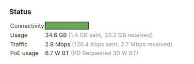

I checked the unifi 360 cameras and unifi viewports as well as our isonas access control keypads and they all show the exact same with the exception of the 360 cameras which show requested 30 W.    The unifi stuff updates pretty regularly so not sure if anything happened recently but the isonas stuff is old as hell (10mbps) and is never updated.
