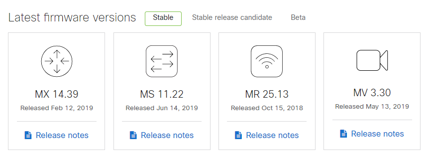

We are using 11.24 on our MS350 without issue.  I'm pretty sure we didn't have any issues with 11.22 either.
11.24 lists this as a fixed bug which might relate to your issue.
  • ARP entry on L3 switch expires despite still being in use -- causing brief packet loss until re-ARP occurs
Hi Philip
Thank's for your reply, but this release 's not stable (Beta)
Do you know when it will be to available
Regards
Meraki's firmware release cycle means it can't be promoted to "stable" until 20% of the devices in the world have been upgraded to it.
https://documentation.meraki.com/Architectures_and_Best_Practices/Cisco_Meraki_Best_Practice_Design/...
So if everyone decided not to upgrade to a newer release of code, code would never progress through the Meraki system.
