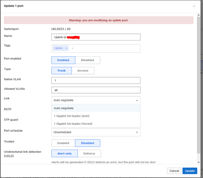

If you connect the SFP+ port to another of the Meraki switch's SFP+ ports does it connect, or do you not have any more transceivers / direct attach cables?
If not then is the port set to 1Gb, or is it perhaps trying to negotiate 10Gb, you can force it to 1Gb in the port config:

This seems to have done the trick! Thank you @cmr!
