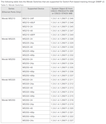

Looked a little closer and the MS410 switch port do not show up either, then after more digging found this from Cisco:
https://www.cisco.com/c/en/us/td/docs/voice_ip_comm/cer/12_5_1/english/release_notes/guide/cer0_b_ci...
This shows list of supported switches.  The MS120's and MS410's are not on the list.  Now the question as of why they are not supported, could still be answered.
