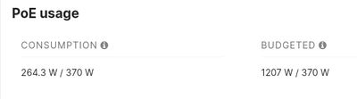

@Speedbird1 you absolutely can go over budget.  See below an MS225 with 41 PoE IP cameras connected:
So go for your option 1.  You can also add a second PSU into the MS355 and if required set the switch to load balance with both PSUs, though this will generate regular spurious alerts so don't set it like that when both switches are up.
