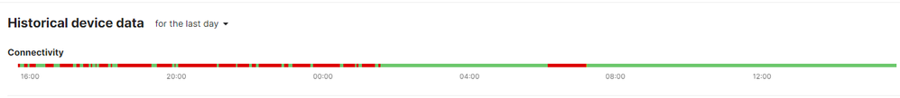

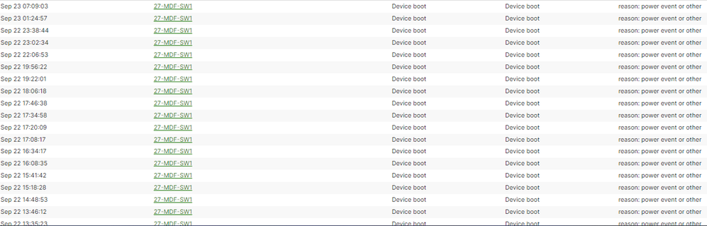

We have two MS225 which are switch stacked and provide uplink to a MS130. Noticed that that the MS225s would lose connection randomly. Thought it was just the Meraki dashboard bug however device uptime indicates that the switches are rebooting for no reason. One of the MS225 switch would deny power to the client devices.
Also have UDLD errors on the port of the connected MS225 switch. (Firmware 17.1.2 would resolve this)
Switch Firmware - 16.9
MS225s connectivity has been stable since last reboot on Sep. 23 7:09:03 CDT.
Opened a case with Meraki. Any reason why this would be occurring?

I RMA both switches and the issue resolved.

Reset the switch using the pinhole button.  It will hopefully recover it, otherwise the power supply looks like it might be dodgy (external or in the switch).

A power supply issues is very possible since it seems to only affect one member of the switch stack.

It is possible that you are entering a panic situation, it happened to me in one, you have to update the firmware, check ups and if you want you can check with meraki in backs log
