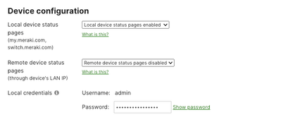

cmr
The username should be admin and the password will be found on Network Wide / General in this section:

kmcgaugh
There is a way to see the login credentials for the local status page of all Cisco Meraki appliances from your dashboard network settings. Go to Network-wide > Configure > General and you will locate the local device status page configuration section.
Now, you could remotely access them with a jumpbox. Some of my customer sites have Windows and Linux NUCs and Raspberry Pi boxes that I can use as jumpbox machines. I have been successful at remotely accessing the local status pages by having a jumpbox connected to the appliance in question, then going to the web browser and typing in http://switch.meraki.com or http://ap.meraki.com. and it successfully give me access; however, this is only dependent upon if the jumpbox is connected to the appliance you want to access. If it's not, then it will only resolve the local status page to the device it is directly connected to.
