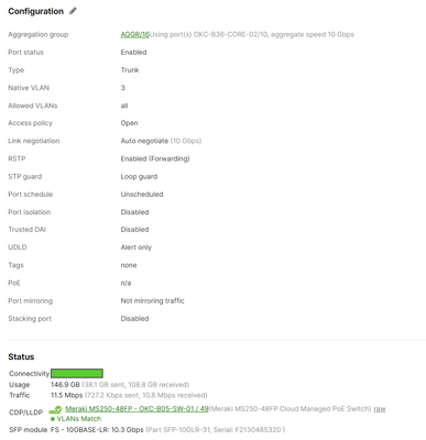

I've been having problems with LACP since update 15.21.1, I was hoping that the update to 16.9 was going to help, but it's made the situation substantially worse.  It used to be that only Cross Stack LACP was glitchy, but now it seems to be even LACP from one single MS250/350 directly to another, no stack involved.
Here's what I'm doing for most buildings.
I have a stack of two MS425's at the core, this stack has one 10G Single Mode Fiber port on each switch configured for a building in an AGG group.  (Let's say port 3 in each switch is in the AGG group of two ports)
I have a single access layer switch, call it a MS350 that has two 10G Ports in an AGG Group, and two single mode fibers connect the switches.
Ports on both sides have RSTP enabled, both agg groups have "Loop Gaurd" enabled.  Here's an example, keep in mind one port is disabled because of this issue, that's why it's only running at 10G
What I'm finding is that Spanning tree will randomly detect these links as a loop and disable them.  Sometimes unplugging the fiber and plugging it back in again brings it back for days, or months, sometimes it detects the loop again pretty fast and goes back offline 10 min later.  The real issue is the intermittent traffic with LACP enabled though.  I will have some ports that cant communicate with certain IP's, but another port will communicate just fine, then 10 min later the issue is gone.  You can always fix any of these issues by unplugging one of the fibers or forcing one of the ports in the group to disabled status.
I've tried to contact Meraki support on this, and I struggle to replicate the issue since it's so random.  If I do enable LACP though, I will start getting phone calls about the network being down/sites being down/glitchy behavior pretty quickly.
Has anyone else experienced this?  Does anyone else have LACP issues?

Thanks for jumping in here RWelch!  On the first issue, I have RSTP enabled globally, with the Core Stack (My 2 MS425-32's) set as priority 0, everything else falls under the "Default" category and gets a priority of 32768.  Just to confirm nothing is messed up, I checked one of the switches in the stack and it says that it's stack is the RSTP Root.
On the second point,... I don't have it configured that way.  I have Loop Guard configured on every link between the core and the access layer, and I have BPDU Guard configured on every user access port.
Will having loop guard set on both sides of an LACP link cause an issue?  Or is this just how you prefer to do it?  Will Loop Guard detect a LACP link like a unidirectional link?  Or something silly like that?
