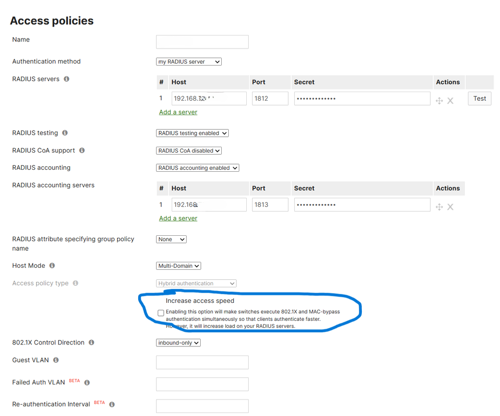

I can get the single phone client to work if I use single host mode, but we are trying to do the "multi-domain" mode since we have PCs hind the phone.
How does the port setting look like?
We set up the multi-domain with VoIP around 2-3 years ago so I might be wrong, but I think you need to provide the vlan and voice vlan on the port despite of the policy "telling" the switch what to do.
The vlan we set up to something that we simply don't use anywhere.
See the below image for port configuration. I still have an open ticket with TAC on this. Making some progress, but no solution yet.

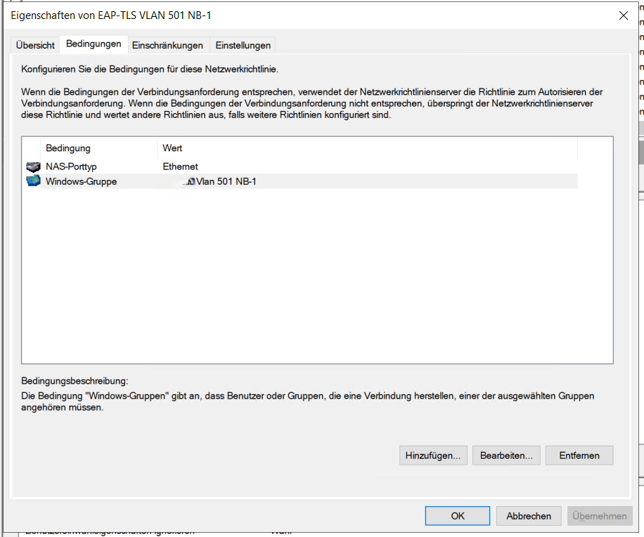

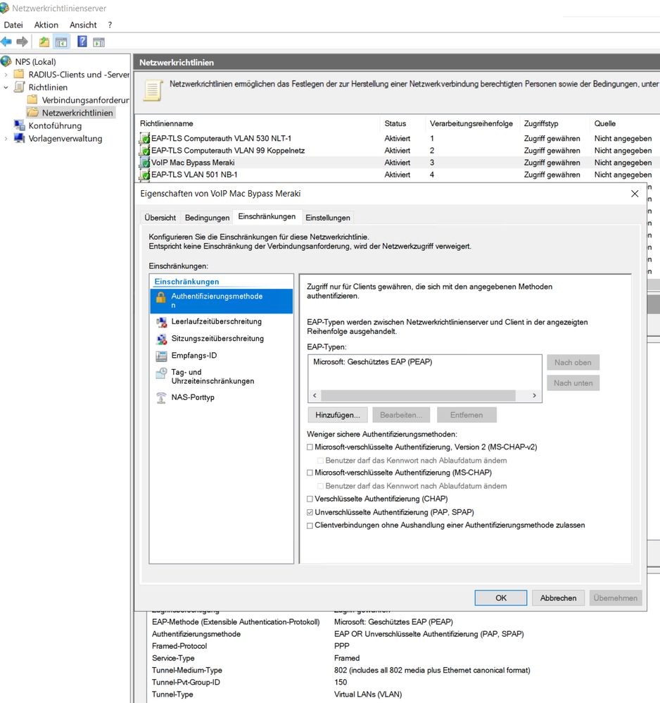

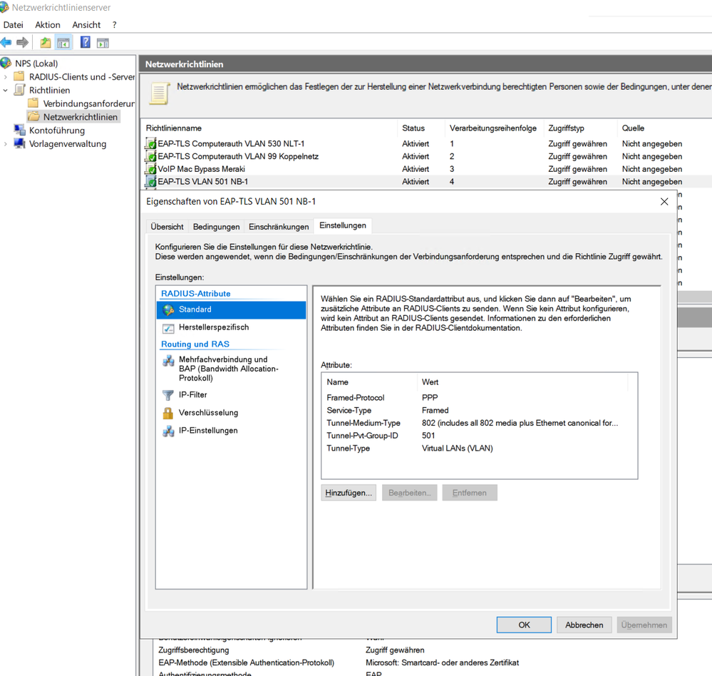

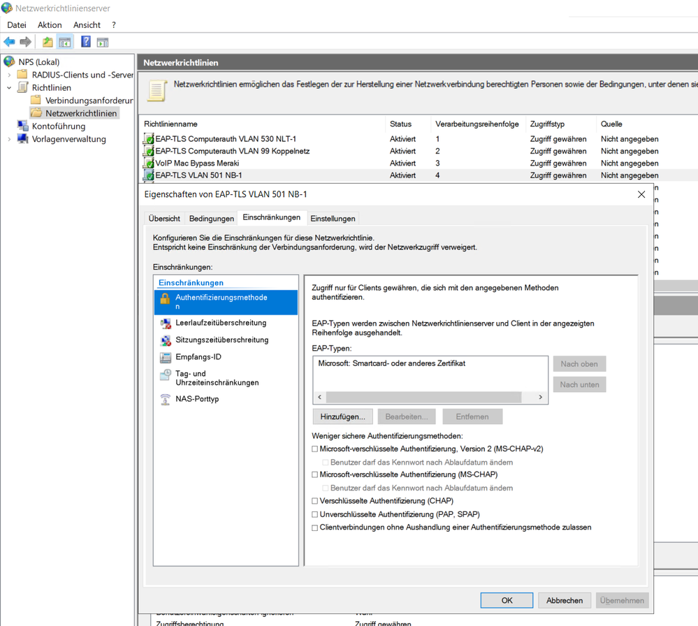

Then i set vlan to 1 the setting does not work. The Meraki switch does not use the cisco-av.pair setting from the Windows Network policy server.
The Port is beeing autheticated correctly but from the av pair setting is nothing in the log.

Your logs and setup look very similar to ours. So far it seem like the issue is because both devices are MAB auth. devices. They are are hitting the same network policy on the radius server. I still have an open ticket with TAC on this, hopefully we have some answers soon.
Wanted to inform everyone that we finally got the issue resolved. The issue was because both mab devices, one being the phone, and the other being a pc, were both utilizing the same network access policy on the NPS server. The network policy was passing the AV-Pair attribute for voice to both devices, causing a conflict. Once I create a separate network policy for each device, the pc and phone both are authenticating like they should.
