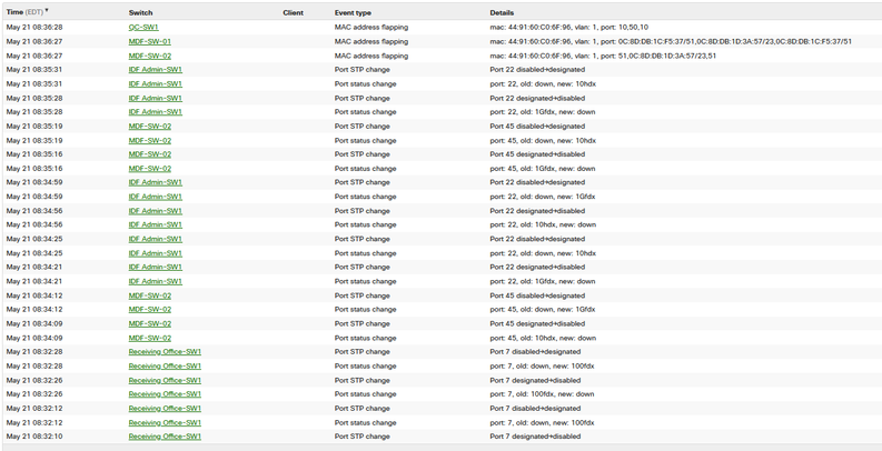

@Bruce- It appears that your theory about excessive STP activity is correct:
**Update** I just spoke with support and they told me the overall STP topology looks stable, and that these events in the log are most likely not having much of an impact.
