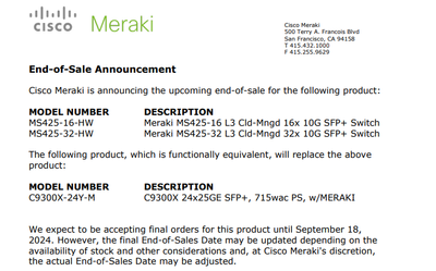

I need to know whether EOL date announcement has been done for MS425-16-HW/MS425-32-HW switches.

OK this aged like milk 😉

It's just like they knew 😉
