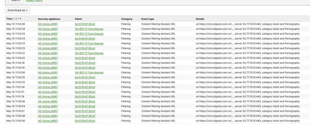

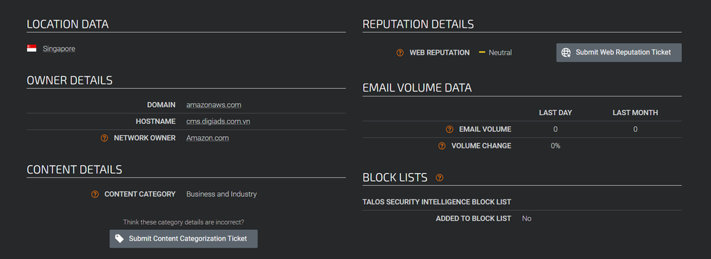

Why is there a difference between our website and the switch's filtering behavior? Despite contacting the Cloud to change our web content category from Adult to Business (Picture 1), the switch is still filtering the website under the old category. (Picture 2).  Can anyone provide insights or suggestions on how to resolve this issue? How can we ensure that the switch accurately reflects the updated content category?
Thank you in advance to those who assist in resolving this discrepancy. Your help is greatly appreciated.

It looks like there are multiple websites on that IP address. If I had to take a punt - one of them has been hacked, and pornography has been uploaded to it.
Just because you request a change of category does not mean it will happen.  It may get reviewed, the reviewer might find that IP address is still hosting pornography, and leave the category as is.
The quickest solution will be to whitelist the website on your own MX.
https://documentation.meraki.com/MX/Content_Filtering_and_Threat_Protection/URL_Block_List_and_Allow...
