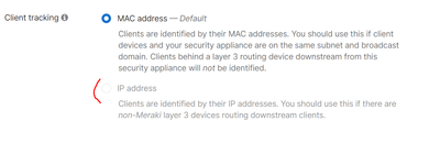

Some of our devices are showing as attached to the wrong switch and switchport in the Dashboard. This only seems to be effecting devices on a VLAN other than the default/main VLAN.
I'm trying to troubleshoot a VoIP issue however the Meraki dashboard says that the phones are directly connected to the core switch stack, (which is operating at L3) via an aggregation port (AGGR/0).
This is definitley not correct, as the only things connected to our core stack are servers.
We are tracking via Unique Client Identifier as we have a downstream MX which is also at L3.
If we change to MAC tracking, will that fix our topology issues?

Probably yes, the IP address track is just for non-Meraki L3 devices.

The documentation is pretty clear that unique client identifier is the correct option for all Meraki networks.  If we switch to track my MAC the MX is not going to be able to see any of the IPs of the clients on the core switch.
