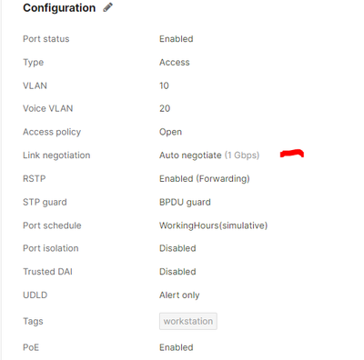

Maybe it will help you.
https://documentation.meraki.com/MS/Monitoring_and_Reporting/Switch_Port_View
But remember, if the port has a 1Gb connection it will never reach 2.5Gb speed.

Thank you, that partly answers the question but doesn't cover 2.5Gbps - what would a 2.5Gbps port connected at 2.5Gbps show? The 1Gbps icon or the 10Gbps icon? Or is there a separate document that applies to switches that have 2.5Gbps capabilities?

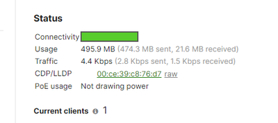

Have you checked the port status to validate which speed is being displayed?
You can check some information on dcloud dashboard.
