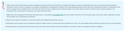

To be honest the documentation is not clear about it, so I suggest you open a support case.
https://documentation.meraki.com/MS/Stacking/Switch_Stacks

Meraki switches work in a different way, where even when stacked, each switch must have its own IP. In other words, it is not possible to reserve the same IP for different switches.
Just a note, this statement is not true for the MS390 ande C9300 models, it does not follow this rule.

The MS390 /C9300-M switches are Cisco Catalyst hardware that run the Cisco IOS-XE operating system.  For stable and RC firmware, the Meraki management software runs in a container on top.  For the beta it is part of IOS-XE.
The other switches are Meraki native with no IOS at all.

Adding to what @alemabrahao said, the management interfaces of each switch have their own Ip addresses, these normally remain constant, regardless of which member is the active stack master.

I should've write it in my original post - the switches in question are 9300. As @alemabrahao wrote, these are different in comparison to lower class switches - meaning 1 IP is assigned to the stack members.
I am curious about the details - ie. I have one IP address assigned to all the switches - how do I configure DHCP reservations? It's not clear to me due to answer of @alemabrahao that would need to be slightly more elaborated.
