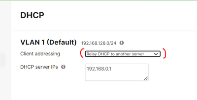

Who is your network's gateway? Is it the MS425? If it is not it, it is necessary to configure the DHCP relay, for example: If it is your MX, it is necessary to configure the MX to make the relay:

The MS425 is the gateway. Thanks for the information.
