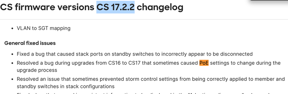

@Willrockhopper ,
Just wanted to add that CS17.2.2 does have a PoE fix. Might be related.
