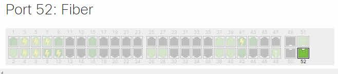

@Hobbes  I see the below when I click on the switch port. What brand of SFP modules are you using, I would say some 3rd party units probably wont show up.

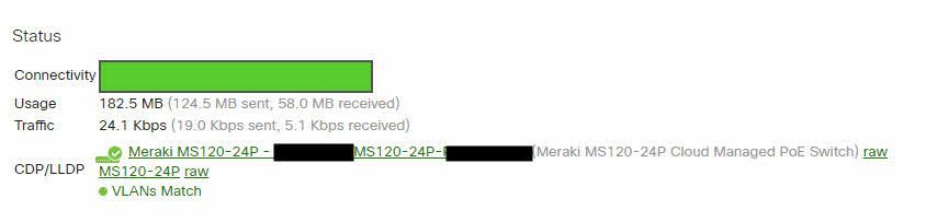

Nope, I can see the CDP/LLDP section where the two switches are listed (both MS120's) but there's nothing there for SFP module. As far as I know, they're supposed to be Meraki branded SFP modules, but I was hoping to avoid a 2-hour drive out to the site to verify.

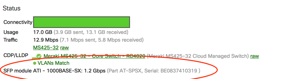

@Hobbes  This might seem like a silly question and its in no way meant to sound rude but are you 100% you are looking at the right port.
I have just double checked one of my switches which I know has a 3rd party module and it does show up information.

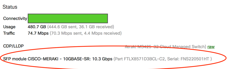

I see what you mean, but like @BlakeRichardson I also have some non-Meraki SFPs installed on a lab switch and I see the information also right below the "VLANs match" information, even the serial number of the SFP.  If you're pretty sure you've got Meraki SFPs installed, might want to open a Support ticket, depending on which model of SFP, which model of switch, and which version of firmware, Support can advise if there's a known issue with reporting the transceiver information, or possibly be ableto see a deeper level of information that you can see natively in Dashboard.  So there's a chance they can save you that drive, might be worth checking.
