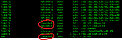

The latest "issue" we've had with them, and which I find as a rather big issue, is that fact that when doing a change on a port, e.g. enabling a disabled port, the port would still have the "shutdown" command even after up towards 30 minutes, despite the dashboard showing the port being enabled. This really makes it difficult to do Acceptance Tests and Failover tests, by simulating link downs in an aggregated port.
We could verify that the switch still had the ports in shutdown mode, with the dashboard terminal view. This stack is running 17.15.3.

The SFP+ ports I have connected are in an aggregation group.  Disabling the group took both ports down and took at least 2 minutes.  Re-enabling whilst disabling a single member didn't seem to work, so I tried it again about 5 minutes later and it worked within about 30 seconds.  Are your ports in aggregation groups?
Edited as I made a mistake....
Second attempt to disable a single member went through in about 30 seconds and re-enabling also worked in a similar time.  However disabling the group did nothing...

We had disabled a member on three port channels, to simulate stack member failure.  On two port channels the member came back up after enabling it again. On the third it didn’t. Dashboard said it was enabled, but the show run, said it still had the shutdown command.
We also had an entire port channel disabled towards a UX, where switches were being replaced. Once they finished that, we enabled the port channel, and it didn’t come up. Show run also showed that the shutdown command was still present.
All this up towards 30 minutes lag. It was as if there was a queue stuck, that didn’t open up until pushing a new command to something different.
