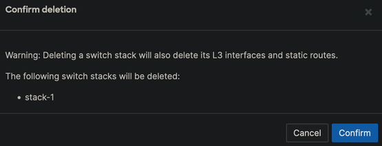

@FrancWest when you delete a stack you will get this warning message. So, just be aware in case there are L3 interfaces configured on the stack today.
Aside from that, no, the config of the switchports is not impacted nor will it reboot either switch. You can delete the stack then remove the stack cables later and it should be fine.
If you have any cross stack LACP aggregation groups configured that will of course be impacted and you'll need to accommodate with a new design.
