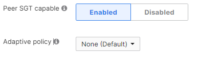

I am trying to get SGT transport working between an MX75 and a C9300. It should be simple enough - but all packets get blocked when I try and enable it.
On the C9300 side I say the port is peer SGT capable.
On the MX75 LAN port, I do something similar.

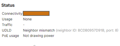

Of note, the C9300 port configured for SGT peer transport frequently generates UDLD alerts.
I've tried several different firmware versions. I've tried a support case (but they have now gone quiet). Annoying, the MX does not seem to be able to do a packet capture of packets SGT tagged, so I can't even examine what is going wrong.
