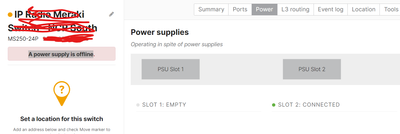

Hi everyone, can anybody help me?
We are getting an alert at one of our Meraki switches. It says, " A power supply is offline". We check the status of the power module and perform L1 troubleshooting such as, rebooting the device, changing the power supply, changing the power module, and adding another power module. But unfortunately, we are still getting the same error. But physically, the switch is powered on and working fine. Is this a bug or something?

I'm having the same issue with an MS250-24P. I tried inserting a brand new power supply; same problem. Even with two power supplies, I have the same issue. An IP phone plugged into the switch will not power on but otherwise the switch appears to be working properly.
