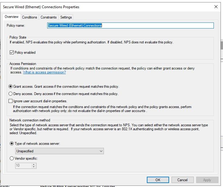

Check which Connection Request policy/Network policy is matching.

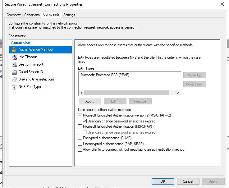

Did you edit the PEAP EAP type to set the inner Authentication method? That is not the MSCHAPv2 that is shown below that box. It has to be configured inside the PEAP config.
I've removed the inside MSCHAPv2. Port still disabled.😕
Check which Connection Request policy/Network policy is matching on logs.
WHAT did you remove? You have to make sure to have the right inner method.
And what are they ?
these my current Authentication methods:
Likely the "Secure Password". Did you add it?

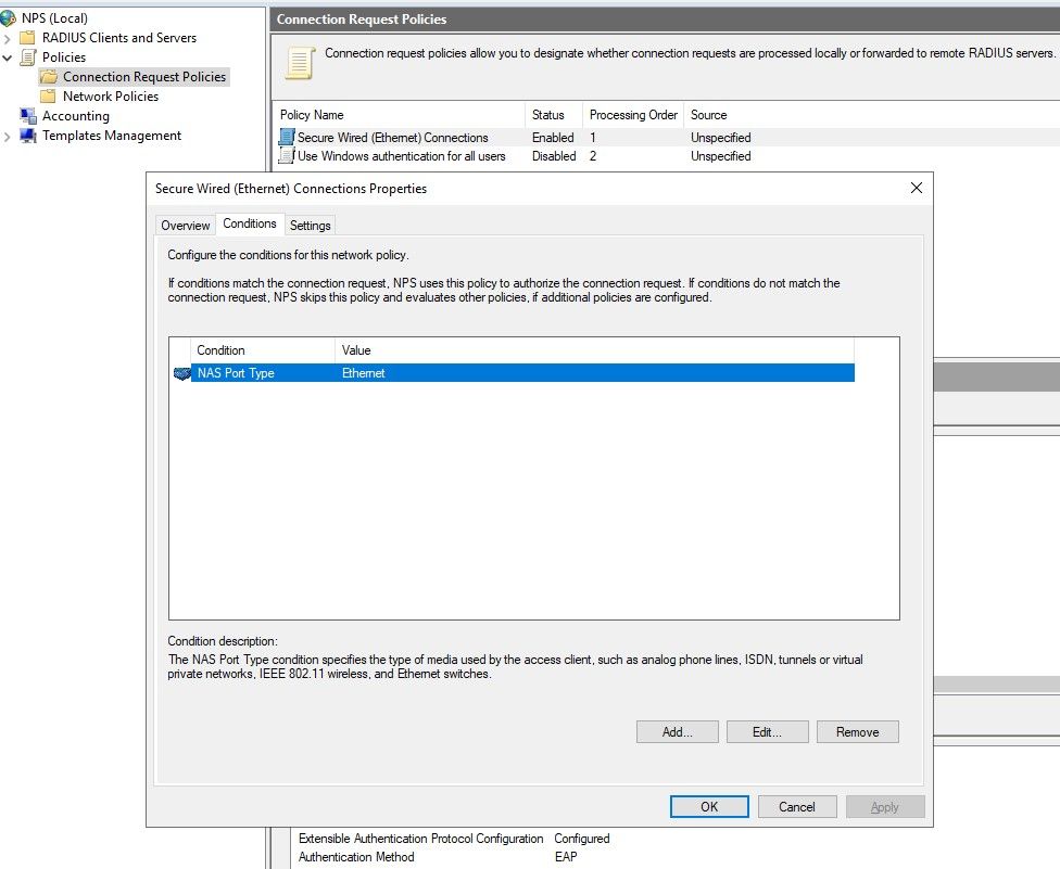

Guys the problem is that it's not matching with any connection policy.

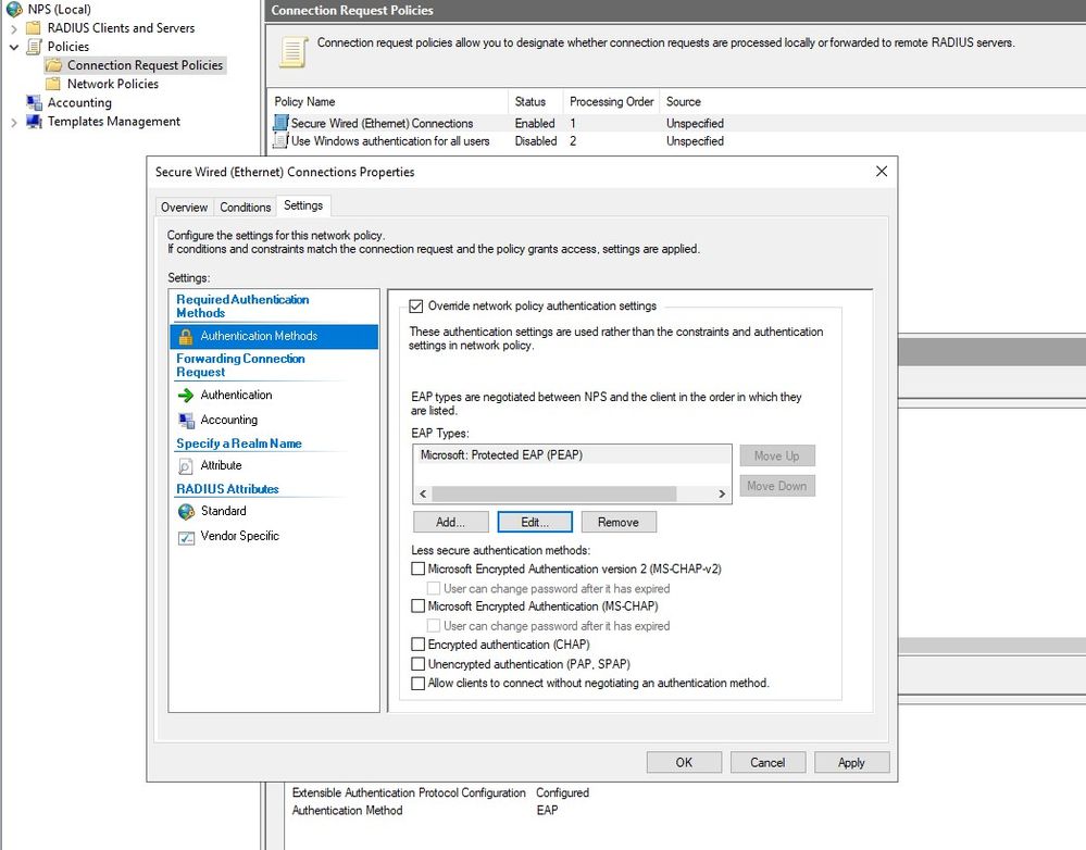

It's very common, create a new connection policy with the the same configuration that you create in the network policy.
I dont have User Group under connection request policy like I have in Network Policy
I don't remember exactly what the config should look like, but this might help.

You need to create a connection request policy.
sure but i already have one configured.
