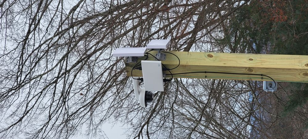

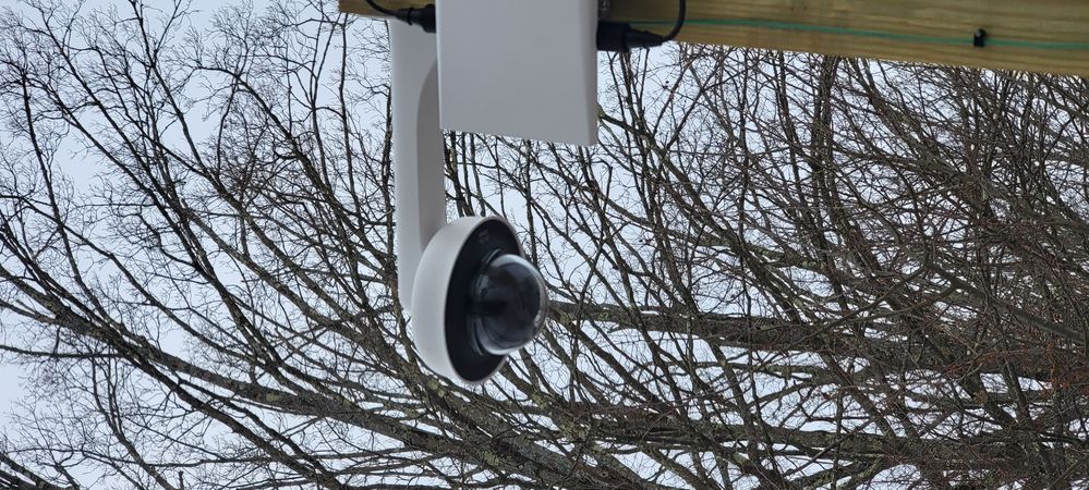

So is the 12VDC line to power the camera like the PoE would? I'm having an issue with snow accumulating on the camera, especially overnight. I can address this by trying to add a shield around the mount but it's tricky....20250106_081214.jpg20250106_081223.jpg
Exactly.
Karl_Jacobsen
Got it.... we'll have to find a way to shield it. Thanks!
cmr
There are sprays you can put on the dome for water to run off, these might also help with snow.  I think @Ryan_Miles has used them and commented elsewhere.
Ryan_Miles
Meraki Employee All-Star
Might have been this comment from another Merakian
cmr
Thanks @Ryan_Miles, indeed it was @GreenMan and RainX does state that it helps keep snow off as well 😎
