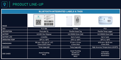

I am currently working on an asset tracking solution that involves using BLE tags. I've been considering using some of the Meraki MV camera models as Bluetooth gateways for these tags. According to Meraki's documentation, these cameras are compatible with BLE devices and can communicate with them within a range of up to 10 meters.
BLE tags from TagNTrack:
