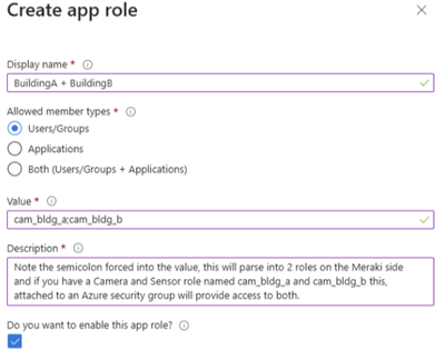

There are multiple approaches.   This is a simpler approach.
Go to entra.microsoft.com, App Registrations.
Search for your application.

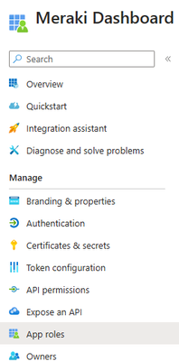

In your Meraki Dashboard application, click on App Roles.
Create as many new roles as required.
Now go back to entra.microsoft.com, Applications/Enterprie Applications.
Search for and go into your Meraki Dashboard application.
Go to users/groups.
Now either add a new user, or select an existing user and edit their assignment.  Assign them one of the new roles that you created.
