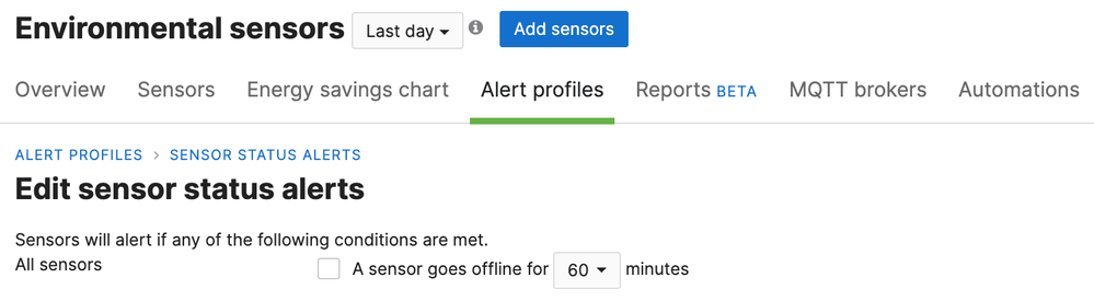

We have had a number of incidents of sensors stopping talking to the cloud.  Most are connected by MRs and at the moment they are all good, however one MT14 that we have connecting via an MV12WE keeps dropping off after a week or so of being connected.  We've been through MV 4 and MV 5 firmwares are MT1.4 and 1.4.1 with the same results.  Rebooting the the MV always brings the MT14 back online.
What I would like is the ability to receive an alert if an MT is offline for a while, in the same way as we can for other Meraki devices.  Does anyone else think this would be useful?

Like this?

Ryan_Miles
Like this?

Thanks @Ryan_Miles I was looking in the network alerts section where all the other offline alerts are set... 👍
cmr
I went round our networks and I'd even set the alerts at one site and then must have forgotten about it!
