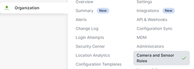

I'm not sure.  Try creating a sensor role by tag here:
Then assign that profile to a user here:
https://documentation.meraki.com/MV/Advanced_Configuration/Restricting_Access_to_Cameras

I do have something like that already. It was working before, but it stopped at some point. Network access here points to certain tag of network.
