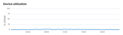

@Radha0545 what is the device % usage down at the bottom left of the report?
Radha0545
Site B
