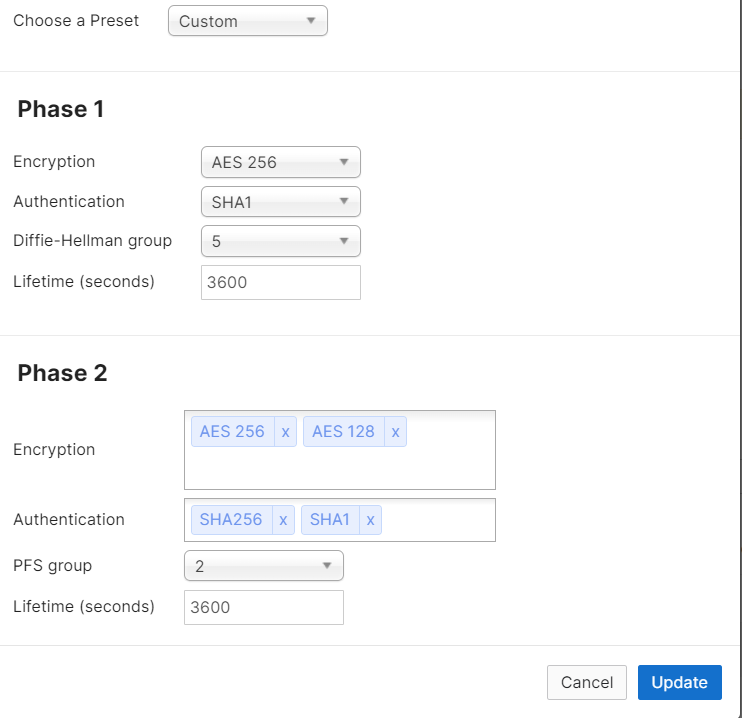

Hi,

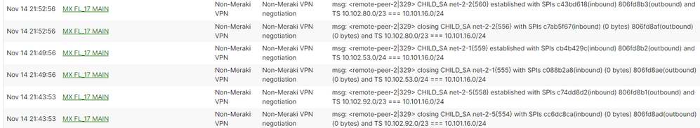

We recently set up site to site between MX 250 and Fortigate. The link went up normally but every day there are lots of disconnections.
Does anyone know the issue?
in The event log has error messages
Thanks
3 Replies 3
How are configured the lifetime on both phase 1 and 2?
I would suggest you to configure the lifetime of 86400 seconds for phase 1 and 3600 seconds for phase 2.
shlomoi
Hi,
Thanks for your help, I set it up like this.
I will change and check
Thanks
