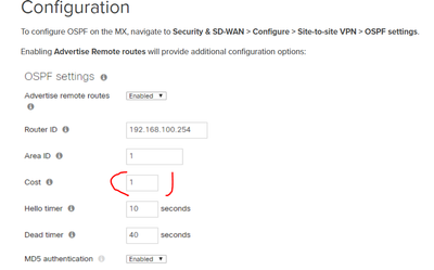

The MX only advertises the networks it knows, in this case the preference configuration must be done on your Core, or you can try to change the cost of OSPF on the MX.
  • Router ID: The OSPF Router ID that the MX will use to identify itself to neighbors.
  • Area ID: The OSPF Area ID that the MX will use when sending route advertisements.
  • Cost: (Defaults to 1) The route cost attached to all OSPF routes advertised from the MX.
  • Hello timer: (Defaults to 10) How frequently the MX will send OSPF Hello packets in seconds. This should be the same across all devices in your OSPF topology.
  • Dead timer: (Defaults to 40) How long the MX will wait (in seconds) to see Hello packets from a particular OSPF neighbor before considering that neighbor inactive.
https://documentation.meraki.com/MX/Site-to-site_VPN/Using_OSPF_to_Advertise_Remote_VPN_Subnets

it won't work on the hub, if I change the cost of the ospf on the hub itself then that hub is either better always or lesser priority always. yet I have some spokes that prefer that given hub.
seems to me only way as you say is directly on the core. but then again I have to know every subnet I want to give priority to on one side vs the other... too much manual entries.
was hoping for maybe some other option :).
thanks.

my other solution is to take my HUB1 which is actually a cluster of 2 test MX105 (active/passive) and split that into HUB1 and HUB3. I make HUB3 ospf lower priority advertisements as you show in the screenshot on top. then 1 spoke will connect to either HUB1 and HUB3 or HUB2 and HUB3. this way my routing issue is fixed since the backup to all spokes is HUB3 and it sends ospf with lower priority than hub1 and hub2.
I'll still wait and consult with meraki and cisco to see what other options I have but for now this will work.
