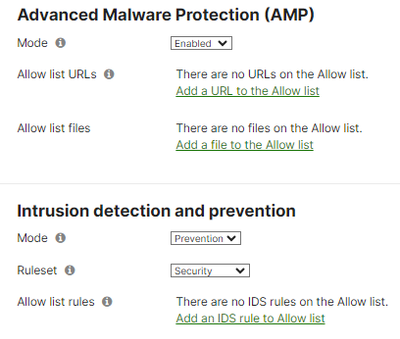

RaphaelL
So you must be running IPS and not IDS right ? Cause IDS won't block
