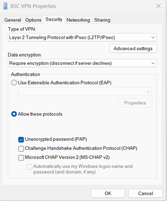

Ok, thanks for the help so far, now after the registry fix and rebooting my computer, I am now getting the prompt for a username and password, but it is giving me a 919 error, authentication protocol used by RAS/VPN used to verify the username/password could not be matched with the settings in your profile. I have verified that L2TP is selected and the key is correct and that Unencrypted Password is being used as per the Client VPN OS Configuration settings for Windows.

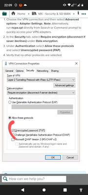

Check the PSK and enable PAP.

I have checked and copied the PSK several times and verified it's correct. Also, the protocol is set to PAP and nothing else:

The truth is that the native Windows client is not 100% reliable and you should not blindly trust the documentation. What I mean is that you can try different configuration combinations, for example, or instead of requiring encryption have you tried changing it to optional encryption?
If it still doesn't work, try generating the connection configuration with this tool.
https://www.ifm.net.nz/cookbooks/meraki-client-vpn.html
