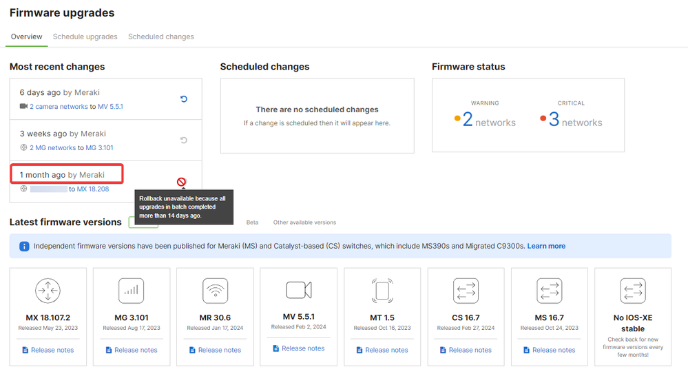

I didnt enable any Beta firmware upgrades or something like this, it was automatically updated itself..
If I go to Organization --> Firmware Upgrades, i can see that this MX was updated a month ago (I guess that back them all the issues started)
How can I roll back? according to the pic I attached it seems like I cant; I can see it grayed out..

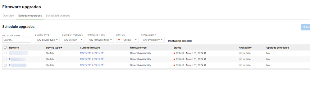

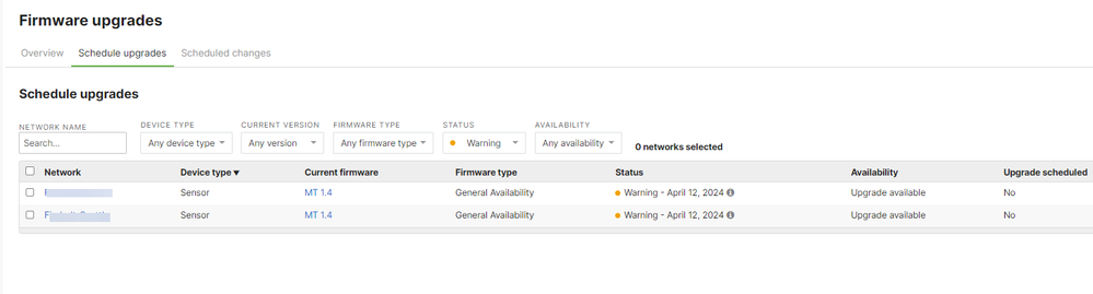

By the way, i can see that i have more firmware upgrades for the switches, should i apply them to install at night you think>?  (Not sure why it didnt install automatically)
I suggest you open a support case in this case.
Since it is not possible to rollback.
