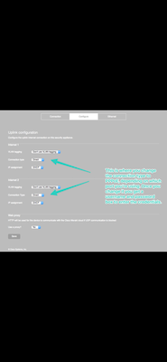

Take a look at this post.  Plug the fibre directly into the MX and configure the MX via the local statyus page.
https://www.reddit.com/r/AskIreland/comments/180s7zq/3rd_part_router_help_for_vodafone_broadband/
Kellysocol
 I was going to do this in the meraki dash board
You'll also have the option to enter any required VLAN tag.
