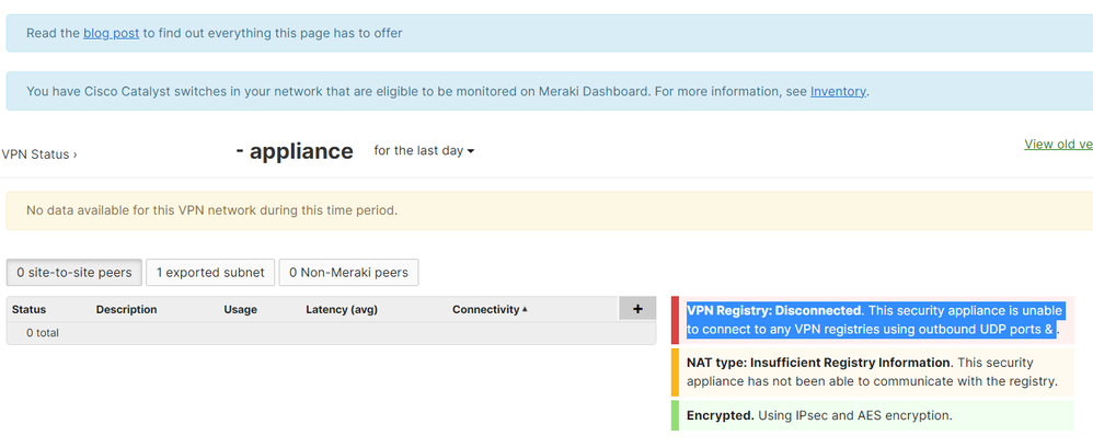

Anyone experiencing VPN Registry Disconnected after upgrading to Ver 18.107.2 from ver 17.10.2. See Pic.

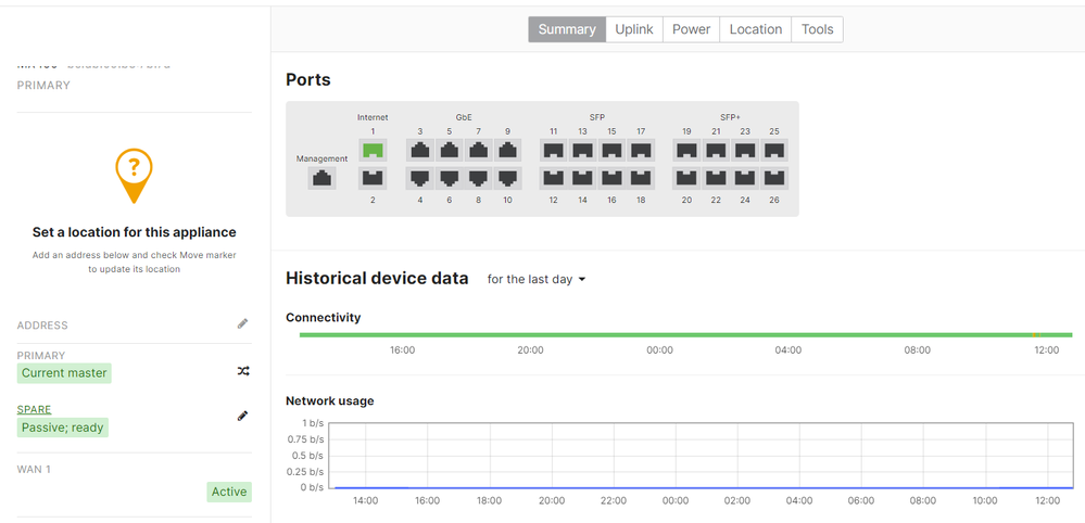

We are running a PoC with multiple MX450s in Warm Spare Mode using AutoVPN to connect spokes to DCs in hubs. See pics.
In each DC we have two pairs of MX450s. Oddly one pair can connect to the Registry but not the other. No outbound firewall filters but all inbound initiated blocked. It only started on firmware 18. Fine with 17.
Will raise with Meraki but wanted to know if its just me?
Many thanks

We have 44 MX450s running MX18.107 and none are showing any errors related to VPN registry.
Since it's a POC , I would reboot 1 set of MX450s , do a packet capture and look for any failed connections that or call Support !

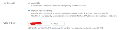

This is a common issue when you are running in VPN concentrator mode behind something doing NAT.  It is not related to the firmware version.  You just happened to trigger the issue through a reboot.
If you configure a manual UDP NAT port forward to the MX the issue will disappear.  As a bonus, this approach also allows more cases of AutoVPN failure to be recovered and allows for overall faster recovery.  I would recommend you change to this approach.
If you don't like the idea of increased fault tolerance and faster recovery, then you can follow this troubleshooting guide:
https://documentation.meraki.com/MX/Site-to-site_VPN/Meraki_Auto_VPN_-_Configuration_and_Troubleshoo...
