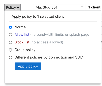

RWelch
If you previously assigned a manual custom GP and applied it to select clients, these clients might still be looking for the deleted manual custom GP.
Have you tried to whitelist (allow list) these clients?
Or you can select them and re-assign the normal profile so they aren't looking for a previously assigned manual custom GP.

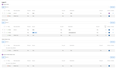

How are your firewall rules and content filtering configuration?

RWelch
overblower
After I added these clients to the whitelist (allow list), it worked.

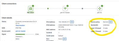

ww
Also check the " show details"  on the client page. It should give you info on what rules are currently used

If you click on a client, on the right-hand side, it shows all the firewall rules and policies that are being applied to the user.
