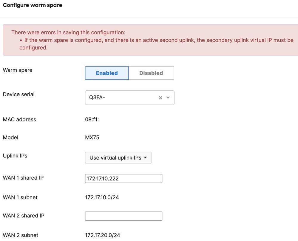

Not sure if the behavior has changed over time, but if use of VIP is enabled both WAN 1 & 2 fields require an entry. This is what happens when you leave WAN 2 VIP blank.
As for your second question the WAN 1 & 2 can be on different subnets on MX1 and MX2 if not using VIPs. Of course failover won't be as seamless as things like natted outbound flows, VPN tunnels, etc would change IPs when failing from MX1 to MX2.

I get the same error whether I attempt it on MX1 or MX2.
I've also requested a doc review as the note in there seems incorrect IMO.
