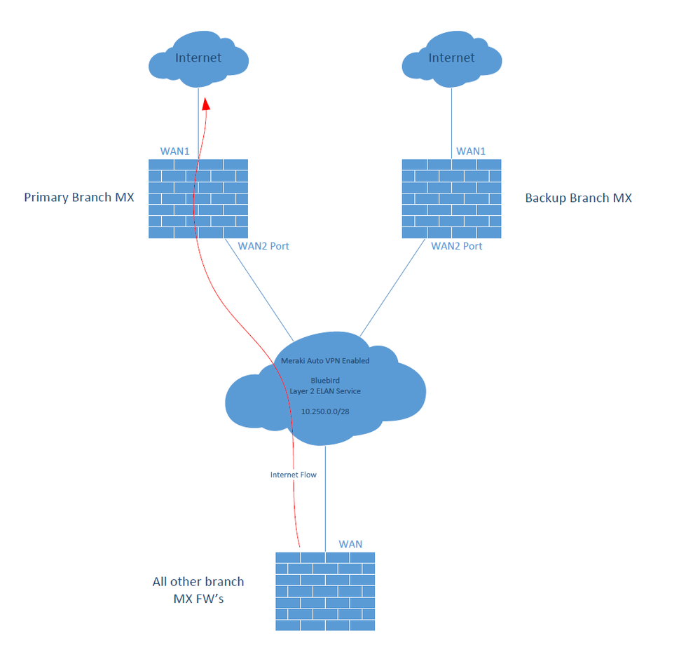

Supported Design? - Layer 2 service on MX WAN interfaces with auto VPN?
See attached. Trying to determine if this would be a supported configuration. No local internet at remote sites. Client would like branch to branch encryption and w/ auto VPN we could failover between primary and backup hubs. I've not been able to find any documentation on how MX handles non-internet links connected to WAN interfaces at the HUB. Can we just enable No NAT across all the non-internet links and create inbound allow rules? Would the MX even try to establish VPN's on the non-internet connected link?

It won't work; MAX needs an internet connection.
ww
No.  These are the two supported topologies:
https://documentation.meraki.com/SASE_and_SD-WAN/MX/Design_and_Configure/Deployment_Guides/MPLS_Fail...
https://documentation.meraki.com/SASE_and_SD-WAN/MX/Design_and_Configure/Configuration_Guides/Site-t...
At a minimum, you would need to modify the design so that the ELAN is connected directly to the Internet.
