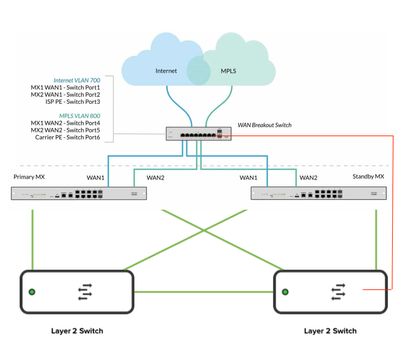

Hi everyone,
I'm trying to use an MS120-8 to split 2 WAN links between 2 MX100s that are in HA. I followed this guide to set up the HA pair using downstream switches in a full mesh config for VRRP.
However, I ran into real issues when I introduced the MS120 between the ISP handoffs and MXs. This is how I had it configured:
The first issue was trying to configure the breakout switch. It wouldn't connect to the Meraki cloud without also being directly connected downstream to one of the L2 switches. Without that connection, the LED would remain orange, and the switch shows as offline.
The second issue is I started seeing 'Uplink IP Conflict' errors on the primary MX. I'm not sure why given that, I have statically assigned the WAN IPs on both MXs.
Finally, I also saw a spike in packet loss, where it used to be 0% before introducing switch, it's now consistently 15-20%.
Unfortunately, I don't have a lab environment to test any of this, so to avoid disruption during our business hours, I've partially rolled back to the following setup which appears to be stable for now:
WAN1 - MX1
WAN2 - MX2
MX1 and MX2 in HA via downstream switches per the diagram.
From everything I've read on here, even a simple unmanaged switch should work, so I'm not sure what I'm doing wrong with this MS120. Any help would be much appreciated.
Thanks.
Raj
I would give the MS120 a static IP address from one of the two ISPs (on whatever VLAN you setup for that ISP) so that it can talk directly to the Internet.  You'll need to configure this via the local status page.
By making your external switch dependent on going through the inside switches and then back via itself - you have created a circular dependency.  So break the connection between the internal and external switches.
You should have a VLAN for each ISP (you can re-use VLAN1 if you like).  Each VLAN should have three ports in it (I'd make them access ports with the info supplied so far).  The three ports are for the ISP connection and a WAN port from each MX.  Repeat for the other ISP and the remaining WAN ports.

typeraj
@PhilipDAth To configure the switch initially I plugged it in downstream, let it download the config, then re-cabled without that downstream connection but with a public IP. After that, it remained orange, until I added that link back to create the circular dependency. Maybe that initial step is where I went wrong?
Also, if I were to give it a mgmt IP from one of the two ISPs, how would the switch behave in the event of that ISP link failing?
@jdsilva Yes, I agree that 2 VLANs are required and that's exactly how I've got it configured: VLAN100 (ISP1, MX1, MX2) and VLAN200 (ISP2, MX1, MX2).
run a dedicated link into is on the "LAN" that's behind the MXs for Mgmt.
Wouldn't this create the circular dependency that @PhilipDAth was referring too?
